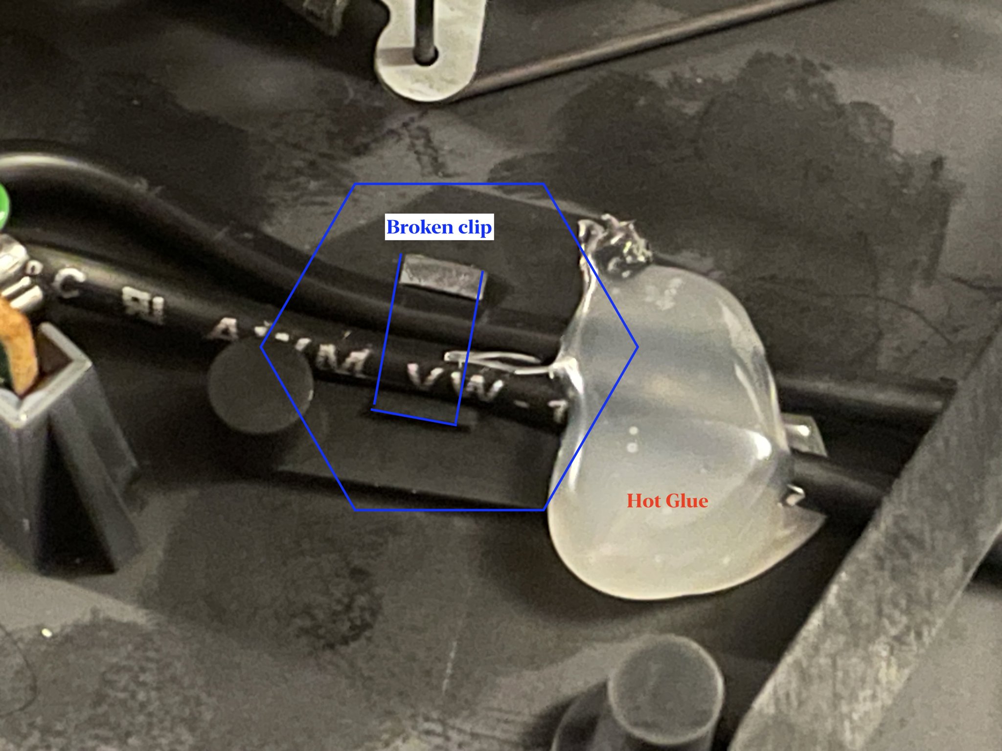

Two cables run from the muting board to the carriage. They go under a black plastic holding bracket. At the bracket pull the cables just 3-4mm towards the carriage - add a dap of glue to them at the bracket, if they won't sit by themselves in this new position. Martin
HI Martin, Thanks so much for the tip, I'll try that today. I had to re-read it a few times to 'visualize it', but now that I think about it there was a thin black plastic 'cable harness clip' under there that was dried out and broken—I figured no worries since there was still that 'black screen' holding the cables down out of the way of travel. I try a dab of hot glue (in hopes it could be removed if needed) Please let me know if Ive misunderstood your suggestion, Thanks K   PS—open to any all glue/adhesive suggestions. And does anyone have any suggestions for BEOs dried out plastic parts? Is there a way to revive them (ie 303 spray?) or maybe I should just 3d print new ones? (its just chore for each custom one-off part)

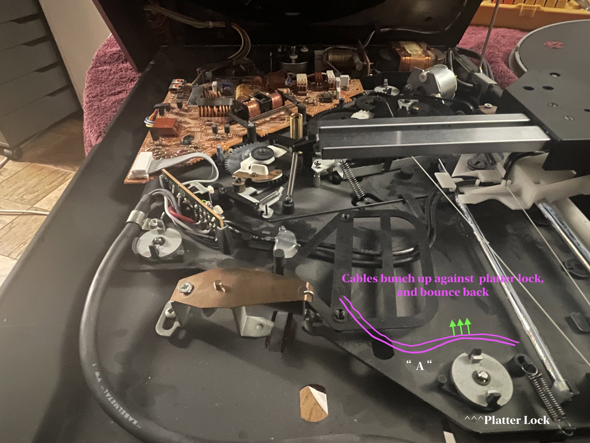

today I finally got a chance to open up the Beogram again. Without that clip, you could see the cable bunch up (at "A") against the Platterlock then bounce back after the arm return ends. @Dillen Thanks for the tip, I hot glued the cables  (adjusted by the clip dents in the cable)—it helped some, the bounce is less. 👍 I'd love to find a new/nos/replacement clip(s), Please let me know if anyone knows of a source or has 5500 parts for sale. Thanks While this helped. theres still a little 'stutter' at the end of travel. It sounds and looks like the gears are still trying to push the arm after its reached its 'end of travel'  (see attached vid clip). This is my 1st B&O so I have no idea what the 'norm' is, could an experienced 'Beo owner' confirm...
  • is this a normal return? (speed seems fast)
  • Are there any marks on the gears (like a car engine) to set 'top dead center' so the gearing and 'end of travel' is calibrated?
  • Is there a way to set the 'end of travel'? (I only see stylus 'set down' points in the Service Manual as an adjustment)

It looks like a normal return. The electronics cannot fail in a manner that would only speed up the return.
